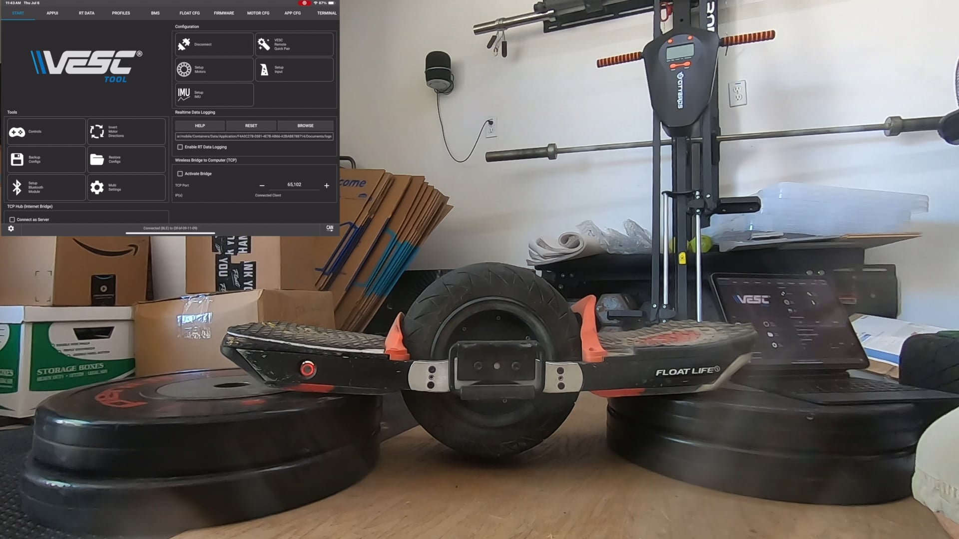

1) Motor config:
Do this first until 9:57 in the video

3) Float Package install:
Next, go back to the first video at the timestamp below and do everything there until about 18:09. Everything after that is IMU config which should have been done in step 2 above.

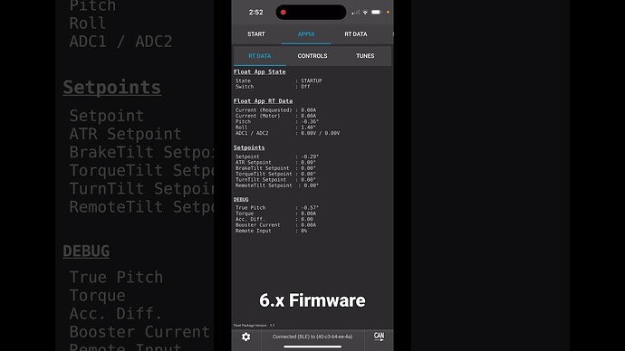

Now, ride your onewheel a bit. Keep vesc tool open in “AppUI” and watch the set points. Make sure your board is level, or raised/lowered however you like it. Use the IMU config to raise/lower your nose so it’s where you like it as a “base”.

Things to always keep in mind: ride your board with Vesc tool open in the AppUI and watch your set points (iPhone users can use the Float Control app also). They’ll help guide you as to what might be right/wrong and where to go from there. Use that info to ask for help.
