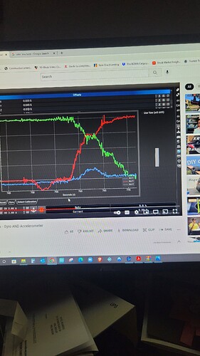

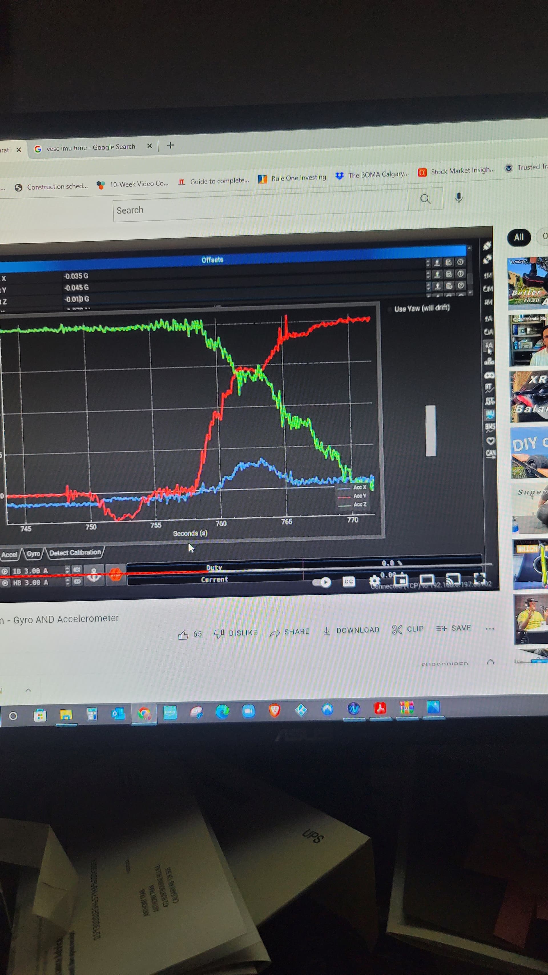

when following SurfDado’s video for imu tuning again, i noticed my VESC orientation when laying on its rails are 90deg rotated from DADO’s image. could this be why my board still shoots off?

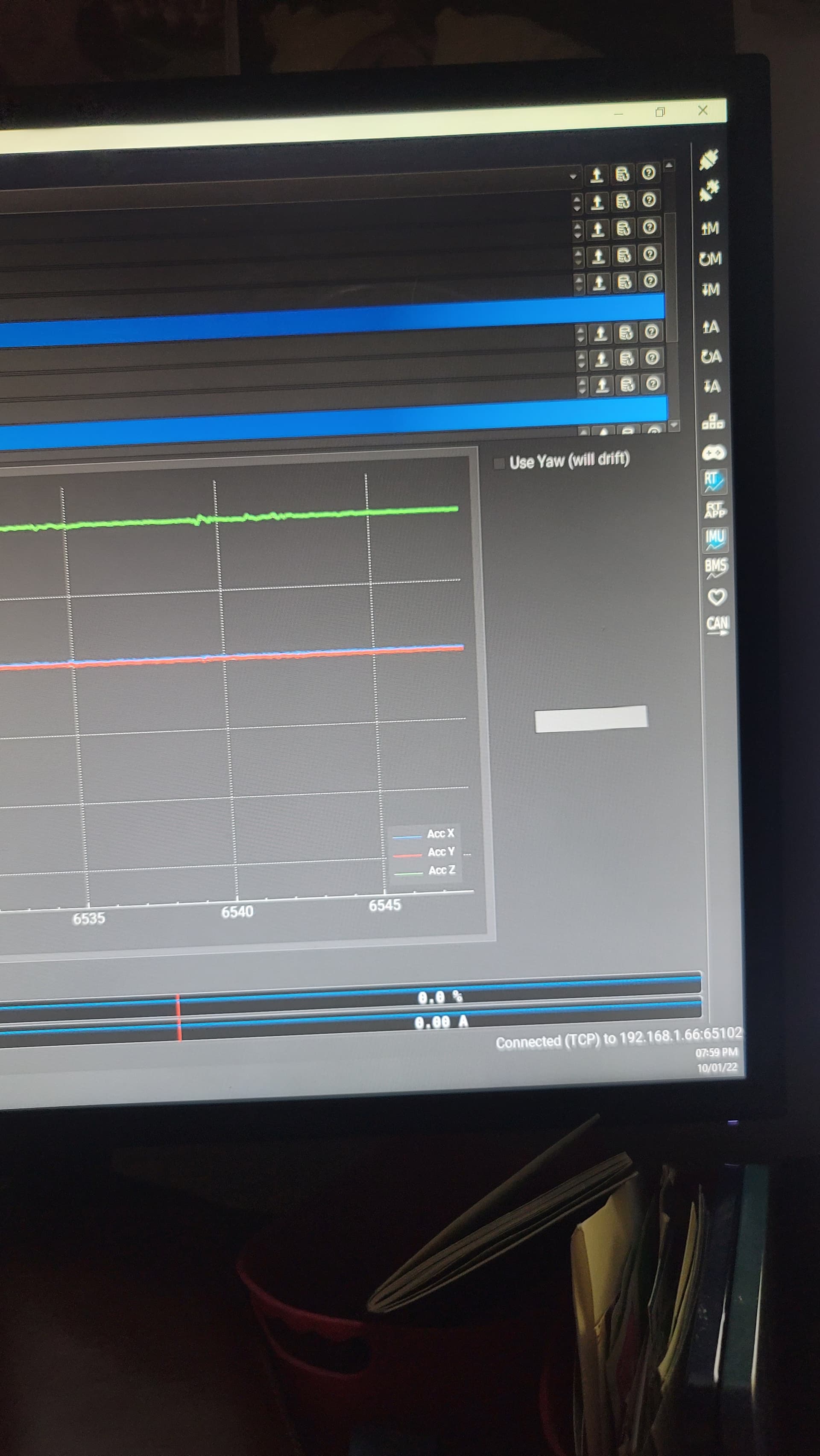

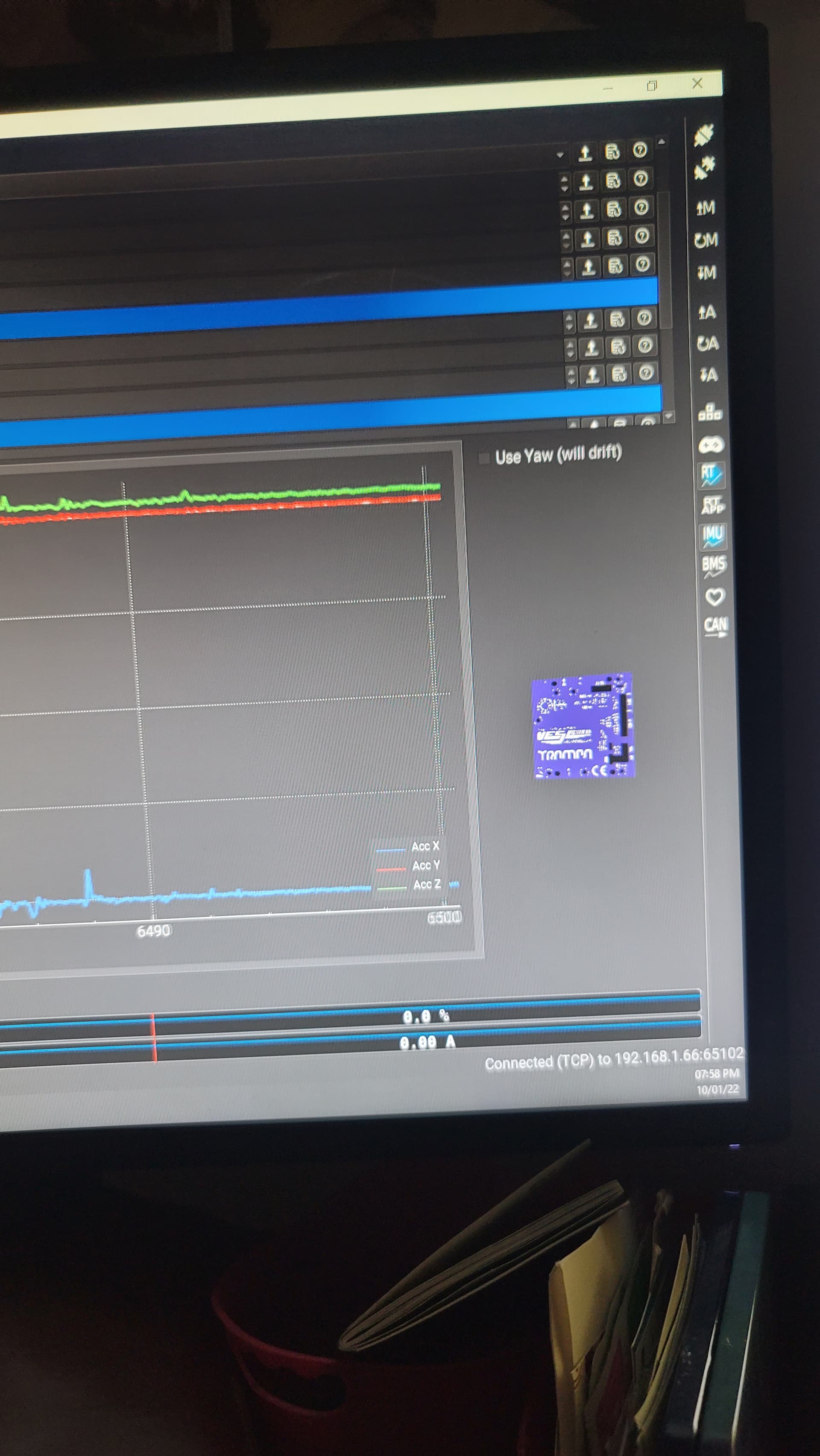

My side rail VESC orientation:
My flat level orientation:
surfdado’s side rail orientation:
