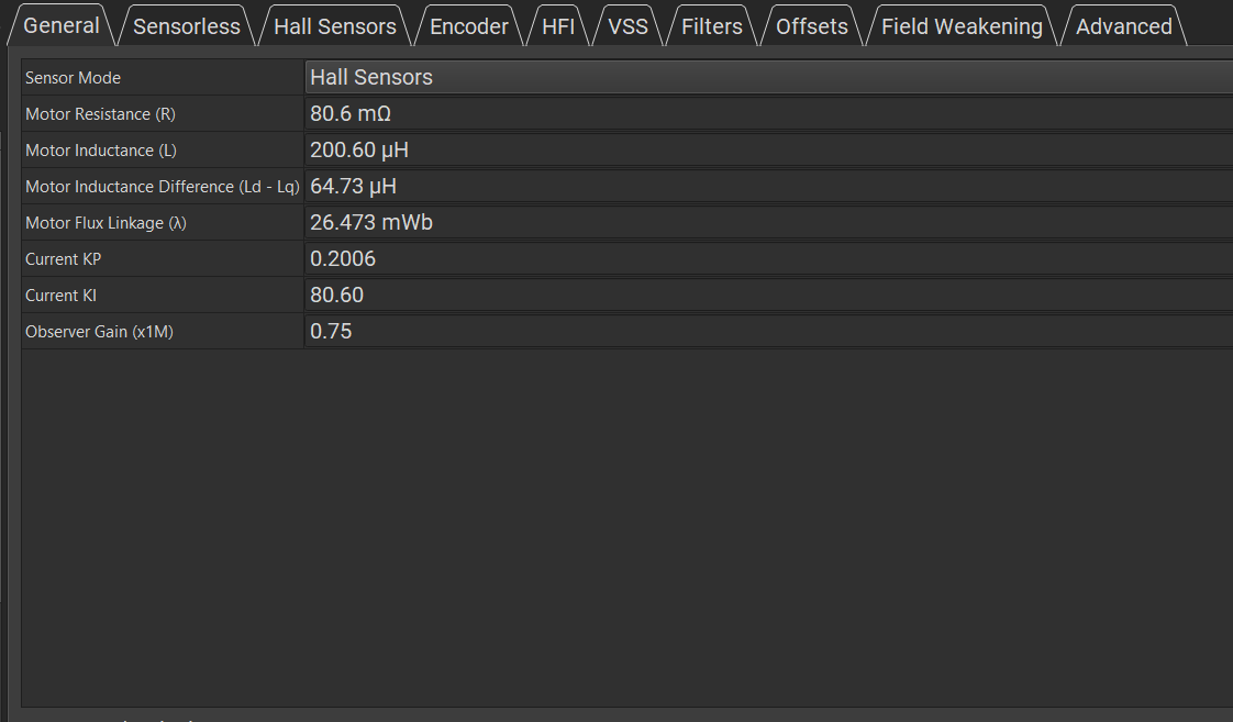

FOC - Observer gain: 0.7 (half of the actual value)

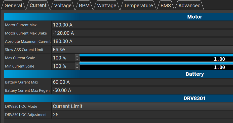

Motor Current: 120/-120 max 180V

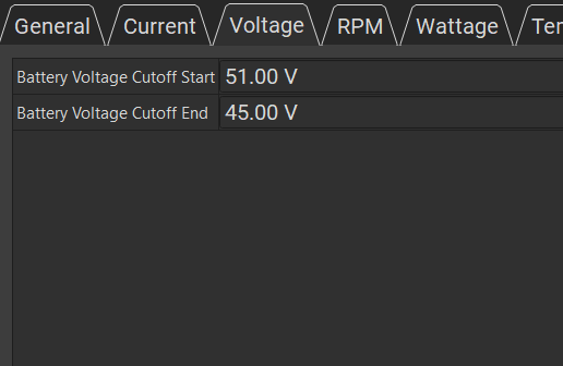

Motor Voltage: start 35V, cut off 30V (stock battery)

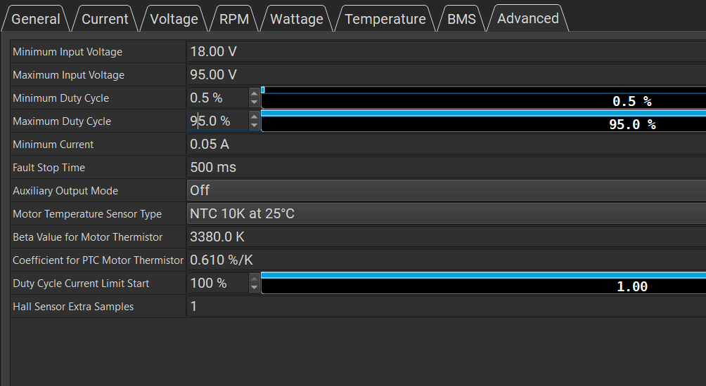

I had observer gain at .75 and motor currents as specified. Did motor detection, my voltage settings were much higher it looks like. I have it parted out right now but have everything I need to put it back together soon. Here are some of the screenshots of my settings.

new firmware will not fix it - you must have some very basic issue. I suggest comparing your XML files against known good ones
you didn’t actually show your motor currents - the defaults from the wizard are not sufficient, see Hannes’ suggested 120A above
The battery voltage cutoff start at 51V will reduce your power and the battery will cutoif at 45V. You will never get a low voltage tiltback with this settings. Change this to the values I mentioned above

motor currents are correct, sorry I missed that one.
