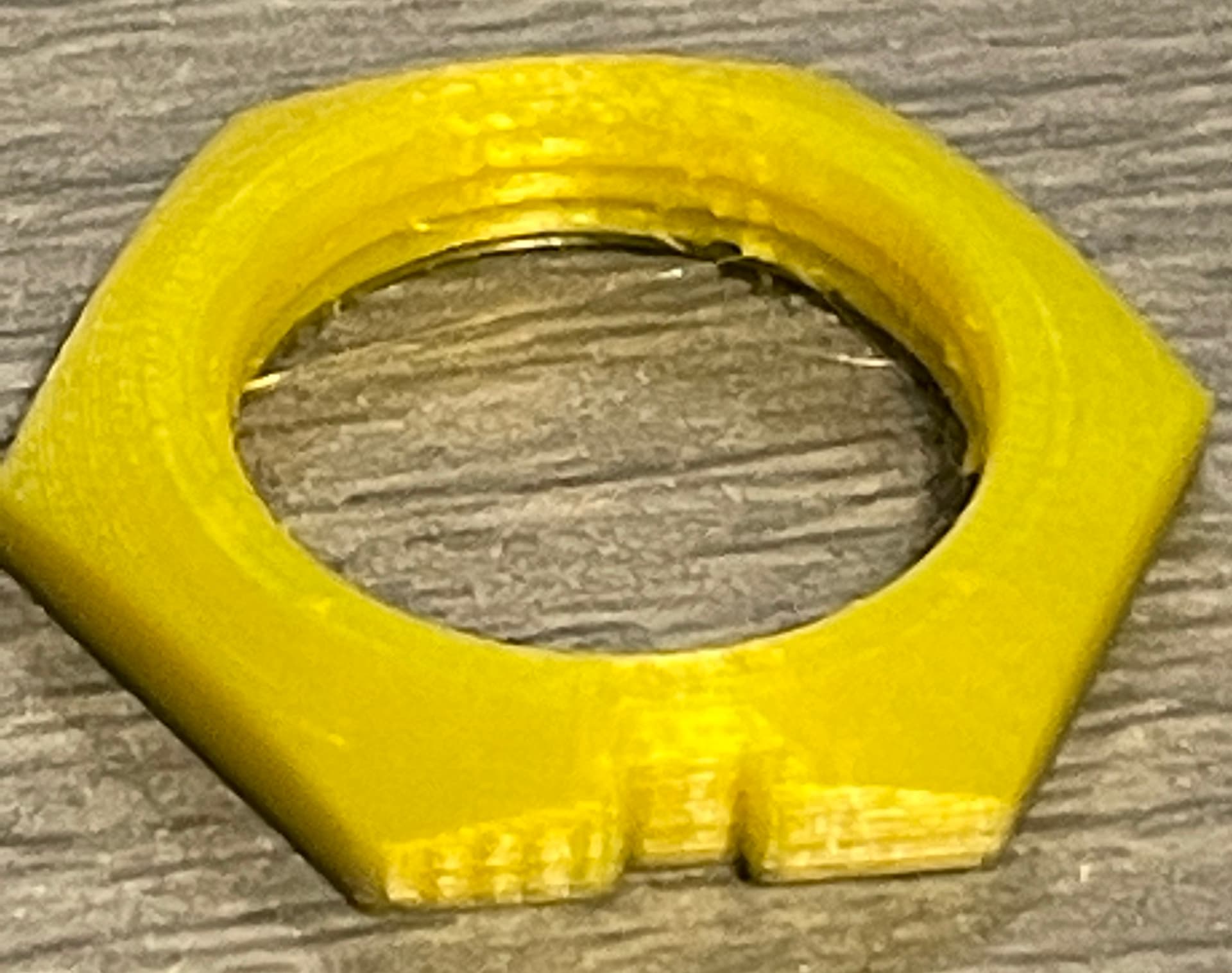

Missing the nut or want one in color? 3D print it - 0.3mm nozzle (0.2 might be even better but couldn’t find mine) and 0.1mm layer height produced great results for me:
Here’s the mesh file for it:
EN3P6MX_Nut.3mf
