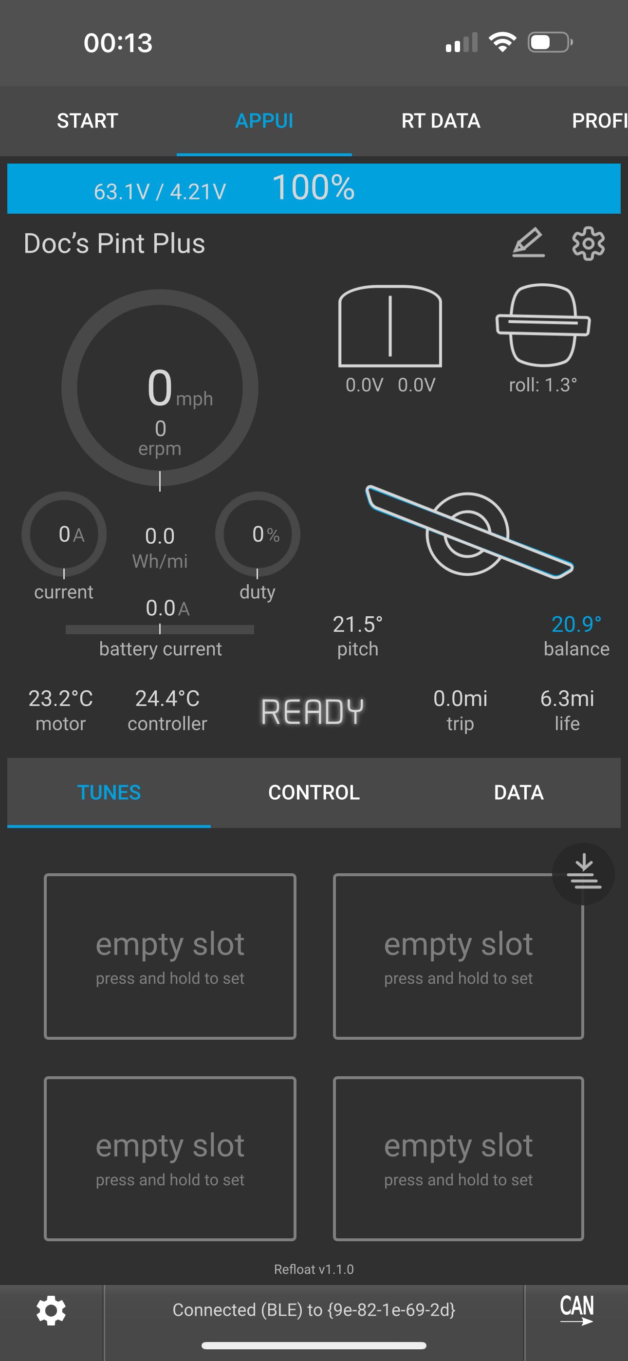

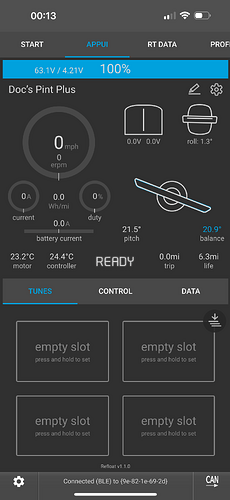

With a new Pint X battery installed, my VESC Tool is saying my battery is 100% charged, whereas the white LED in my footpad is suggesting ~40%?

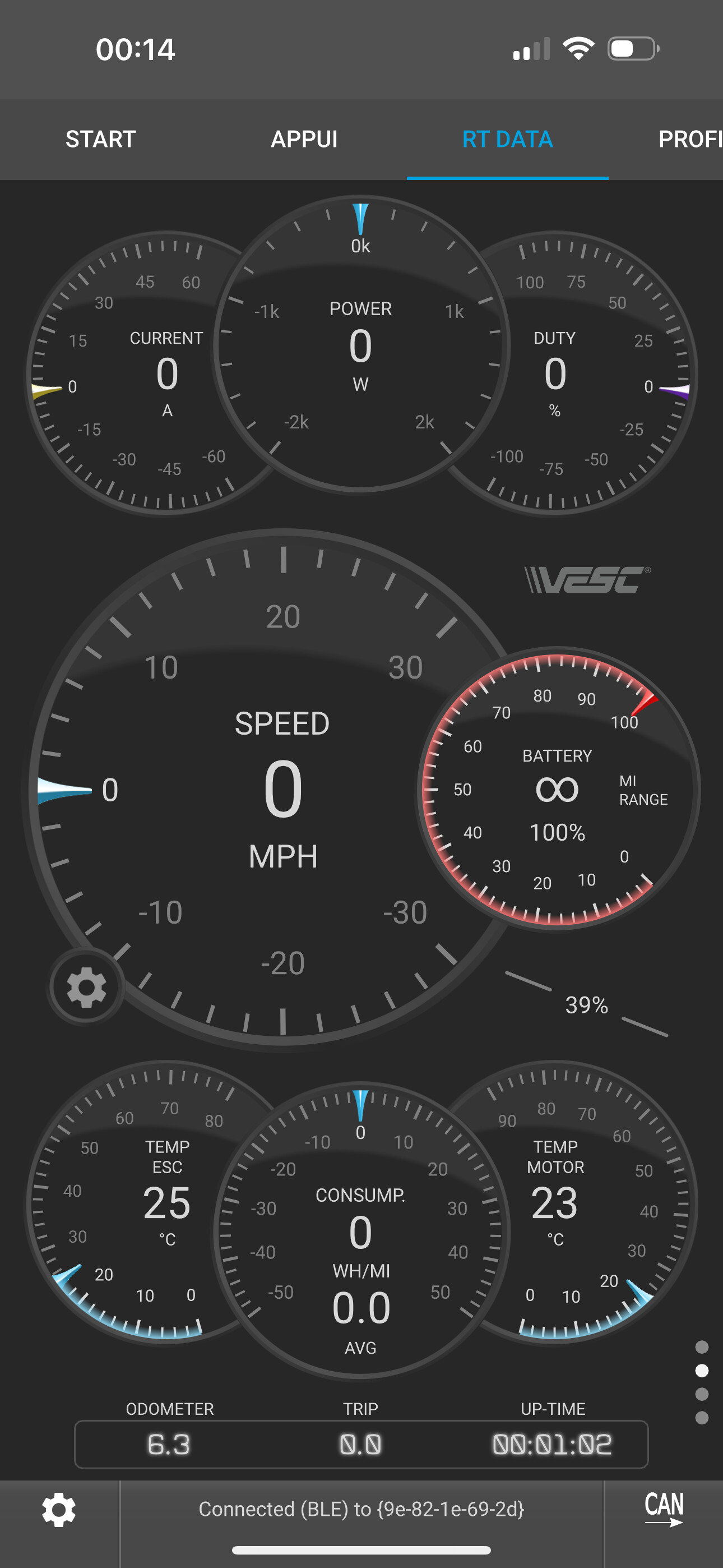

Anyone know what the “39%” value displayed between the “Battery %” & “Temp Motor” dials indicates?
