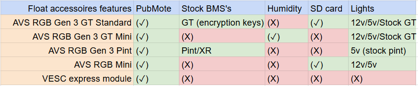

what can float accessories do?
-Lighting control
-Pubmote receiver
-Humidity sensing
-ReFloat data logging
-Stock pint/XR/GT BMS to VESC BMS info translation
-Data logging
Different hardware supports different features.

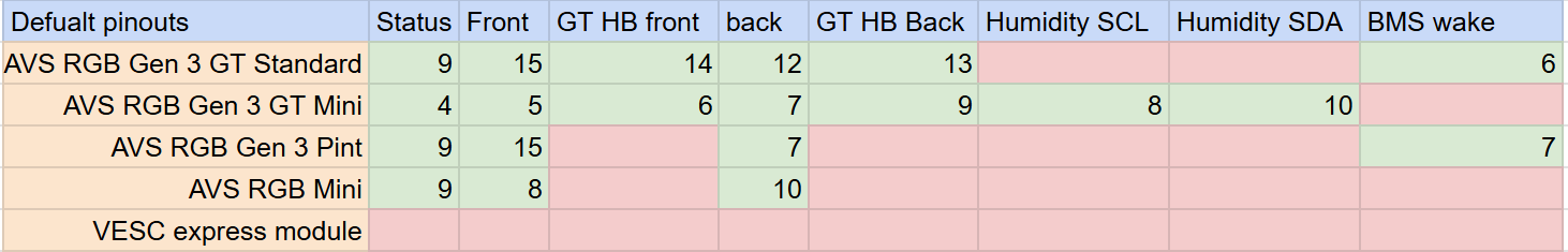

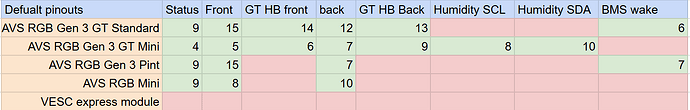

Pinouts for different modules. (should come pre set for the most part if you are using a GT/Pint module)
In general Canbus on the Vesc express/RGB module should be the lower then the controller. (Never set to ID to 1)
(Never change Canbus BAUD rate / Status message rate, unless you know what your doing), by default they will work with the default VESC rates)

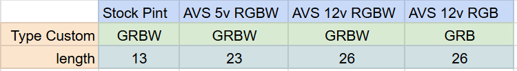

Some settings for common LED types that don’t have a preset
