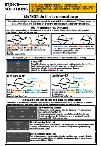

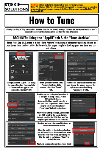

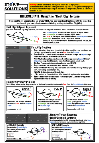

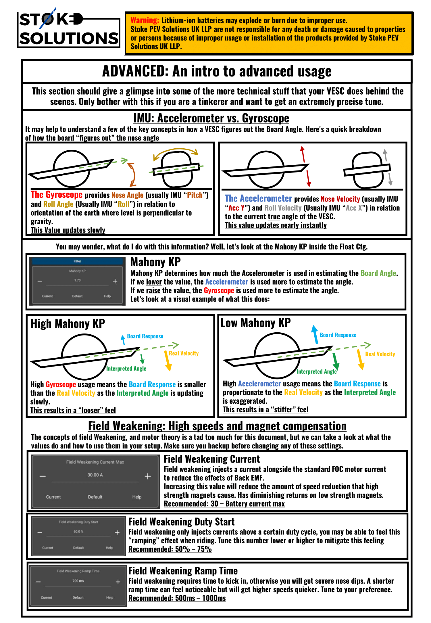

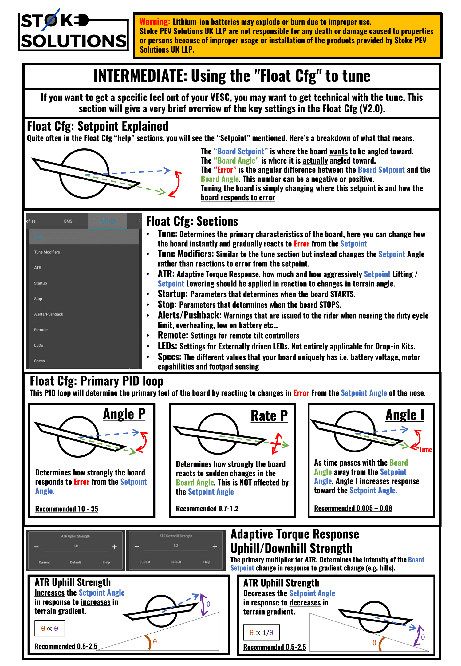

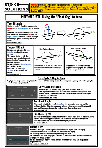

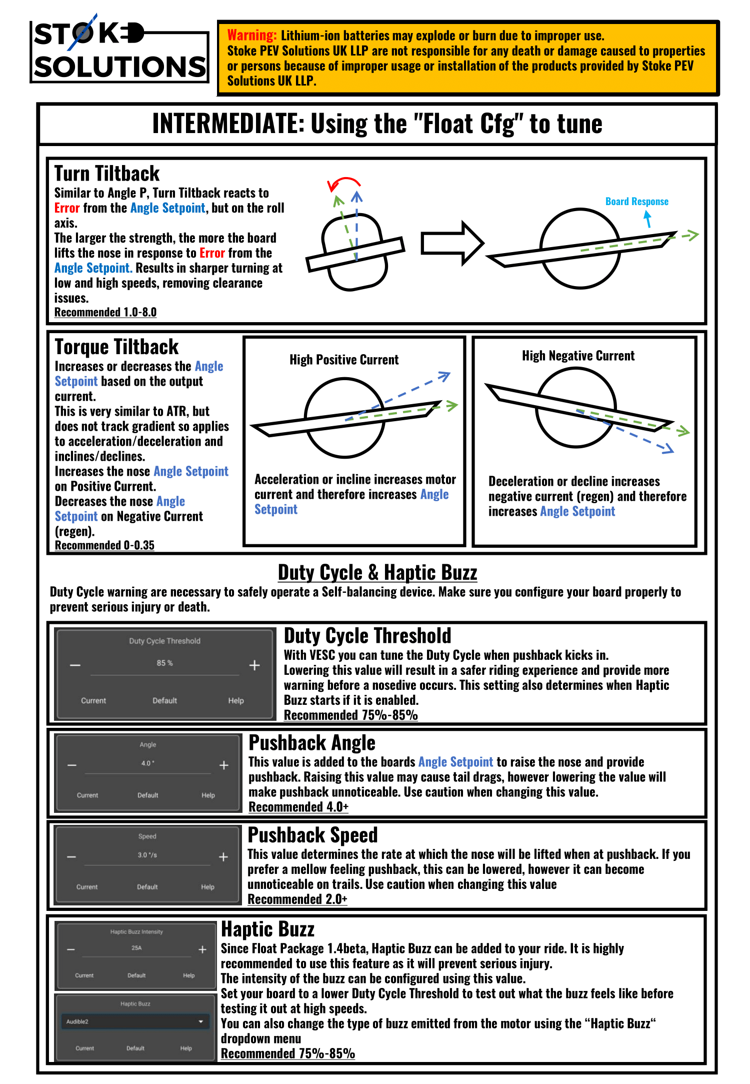

How to Tune Shortened-1
1500×2167 412 KB

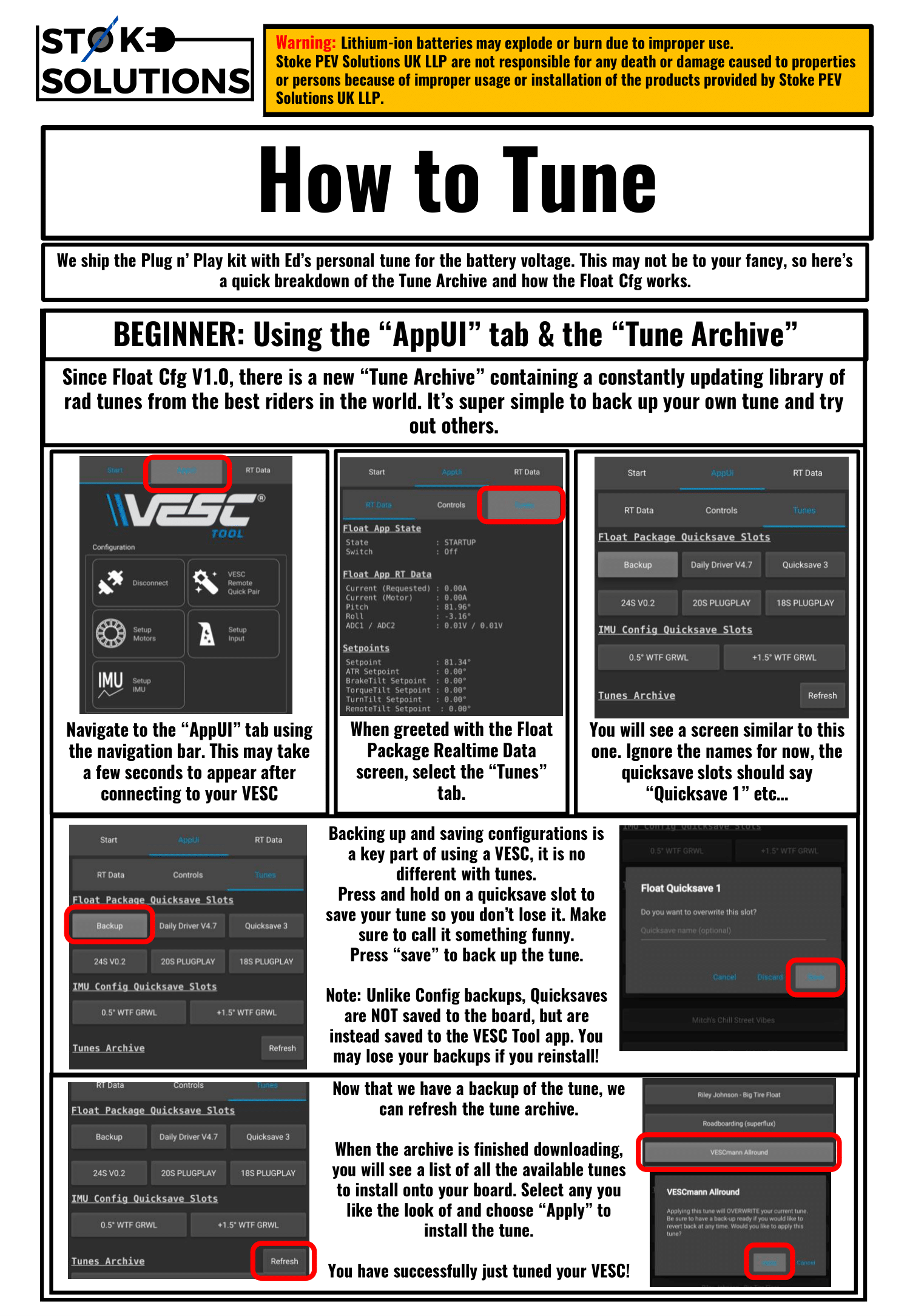

How to Tune Shortened-2
1500×2167 319 KB
How to Tune Shortened-3
1500×2167 289 KB
How to Tune Shortened-4
1500×2167 329 KB
