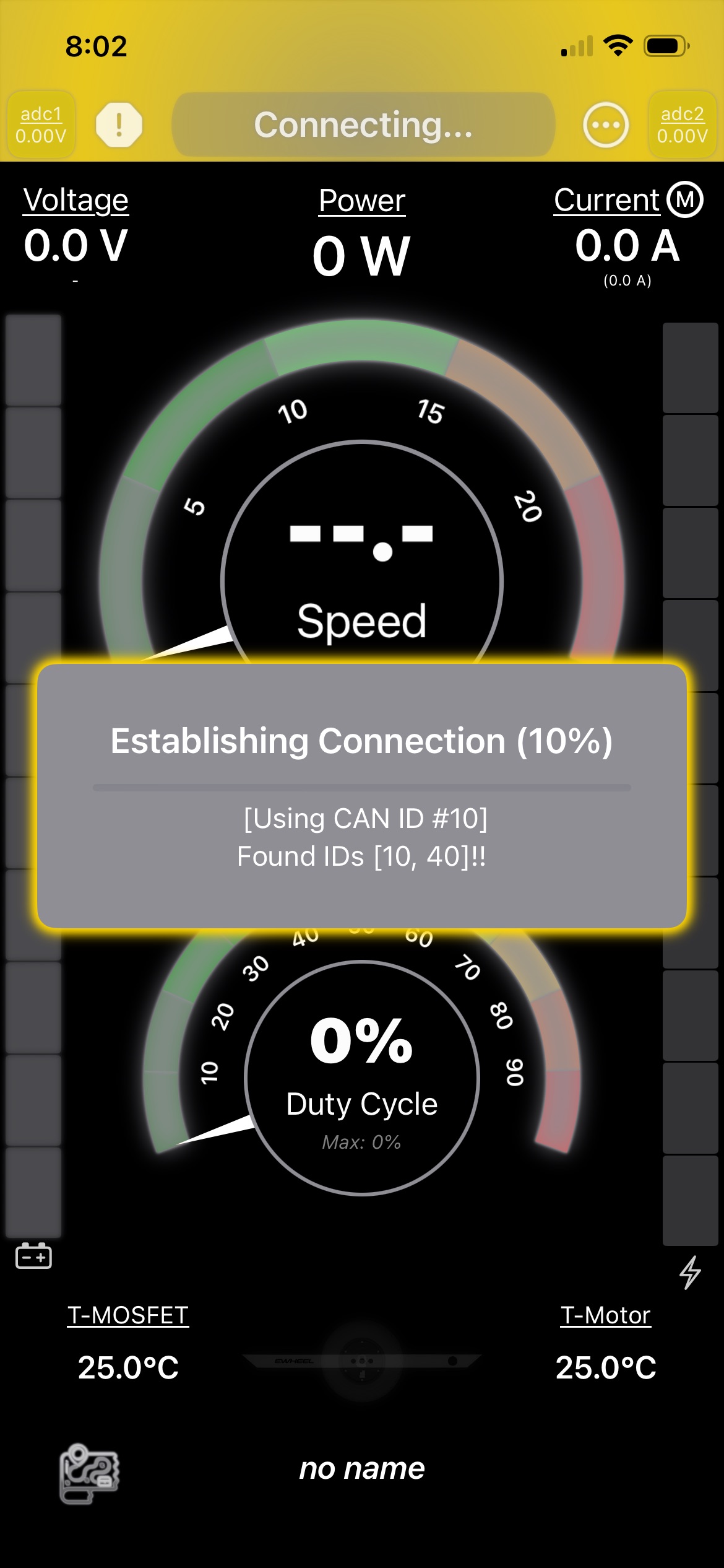

Float Control is getting stuck connecting to my Thor 300 with an Enoid XLite v4. Anyone have any suggestions how to solve this?

My Enoid XLite BMS was originally set to CAN ID 10, which is what Float Control kept trying to connect to—meanwhile, the Thor 300 was sitting on CAN ID 40, and VESC Express was still at its default ID of 2.
After reviewing the reference YouTube video. I reshuffled the CAN IDs to make the order and proximity more logical.
I’ve now got:
• VESC Express at ID 2
• Thor 300 at ID 3
• Enoid BMS at ID 5
With this setup, Float Control locks in quickly and everything’s working as expected.
