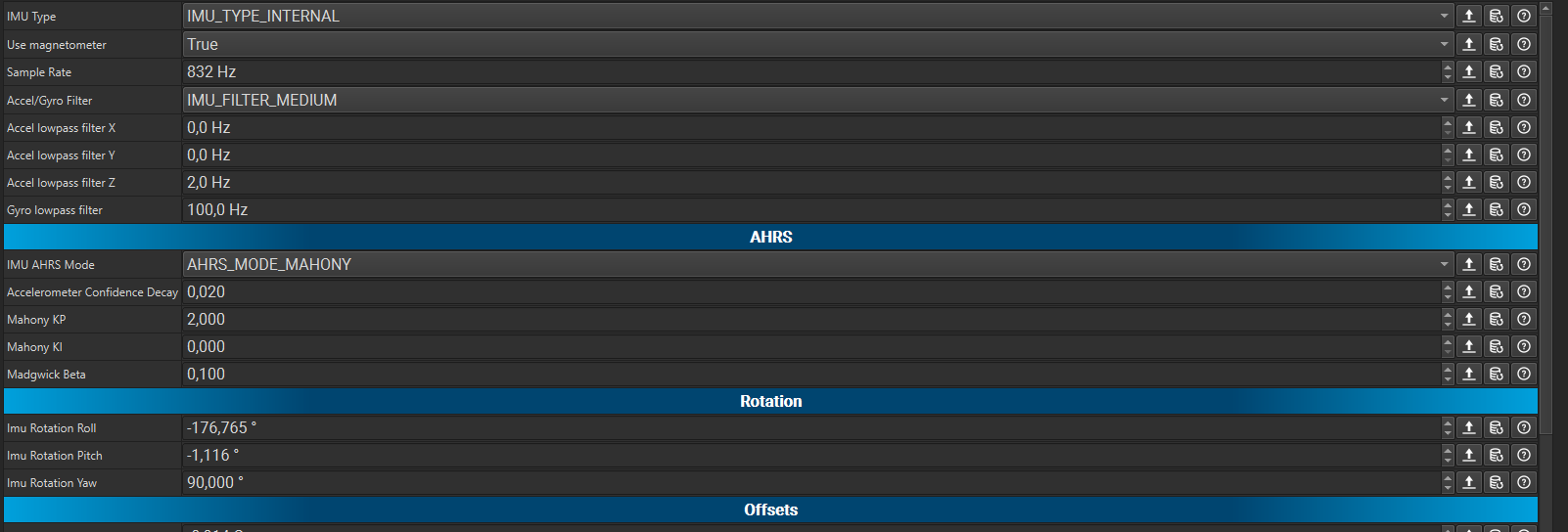

hello my friend has the same problem, we fixed it by putting the sample rate to 832 instead of 416… give it a try ![]()
Hello, My sample rate is already at 832Hz… ![]()
Your gyro z filter isn’t 1

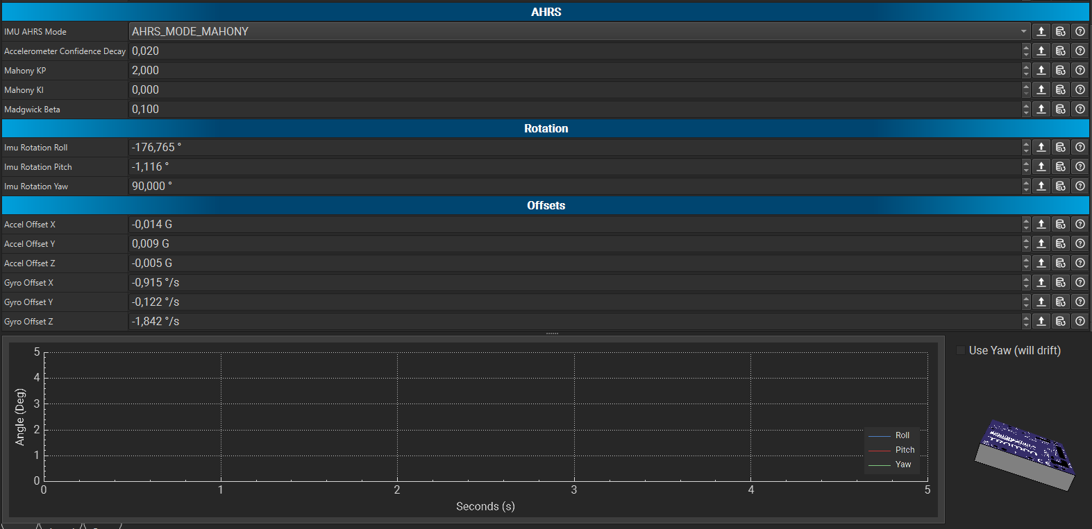

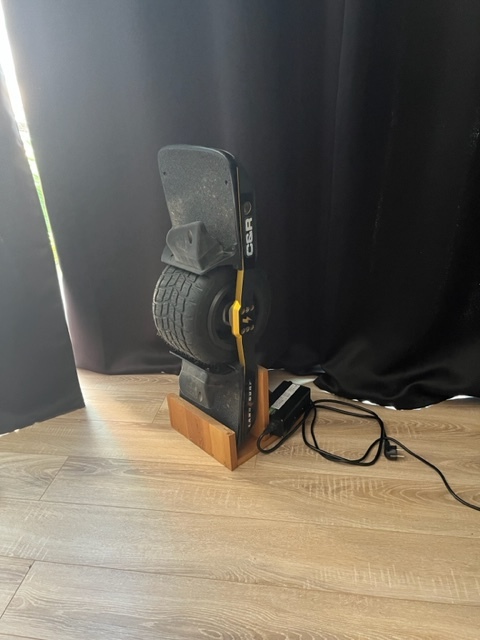

My Board is placed like the picture attached, giving those values… And what is curious, the board placement on the drawing is not the same position…
