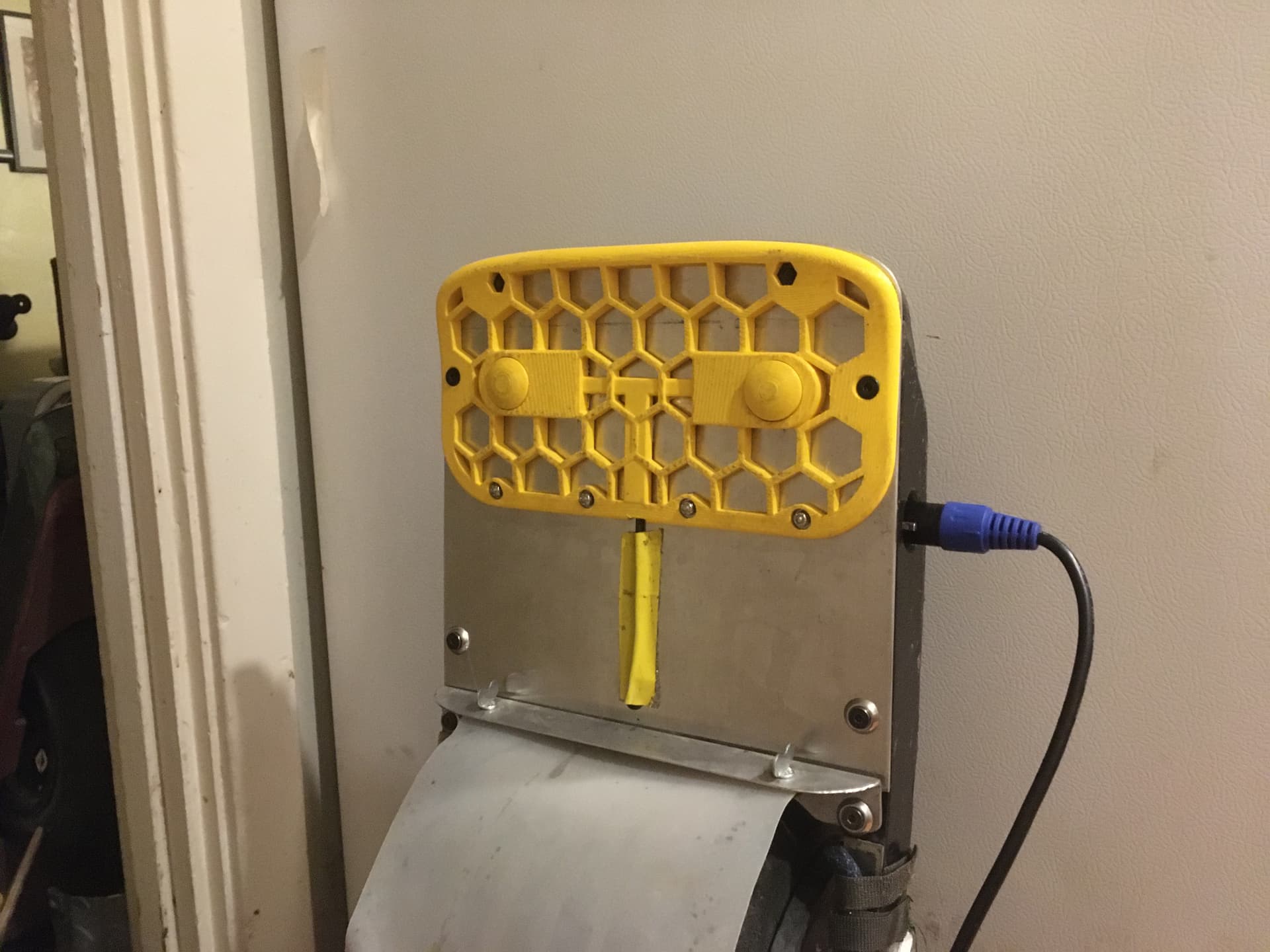

I’m working on my own front foot pads to better match my riding style. I am still on the onewheel controller. VESC is my next project. Here is what my first one looks like so far:
It uses these switches McMaster-Carr
For the most part it works great. I was in the park doing 180’s and bonks but it has one weird behavior that I was able to repeat. When I am pulling high amps and jump off it will stay active for an extra few seconds. I know the switches are not sticking. It happens only when I am stalling or close to stalling the motor, like when you tail slide to a stop and lift your foot off. The motor will stay rotating for a solid 2 or 3 seconds on the grass.
