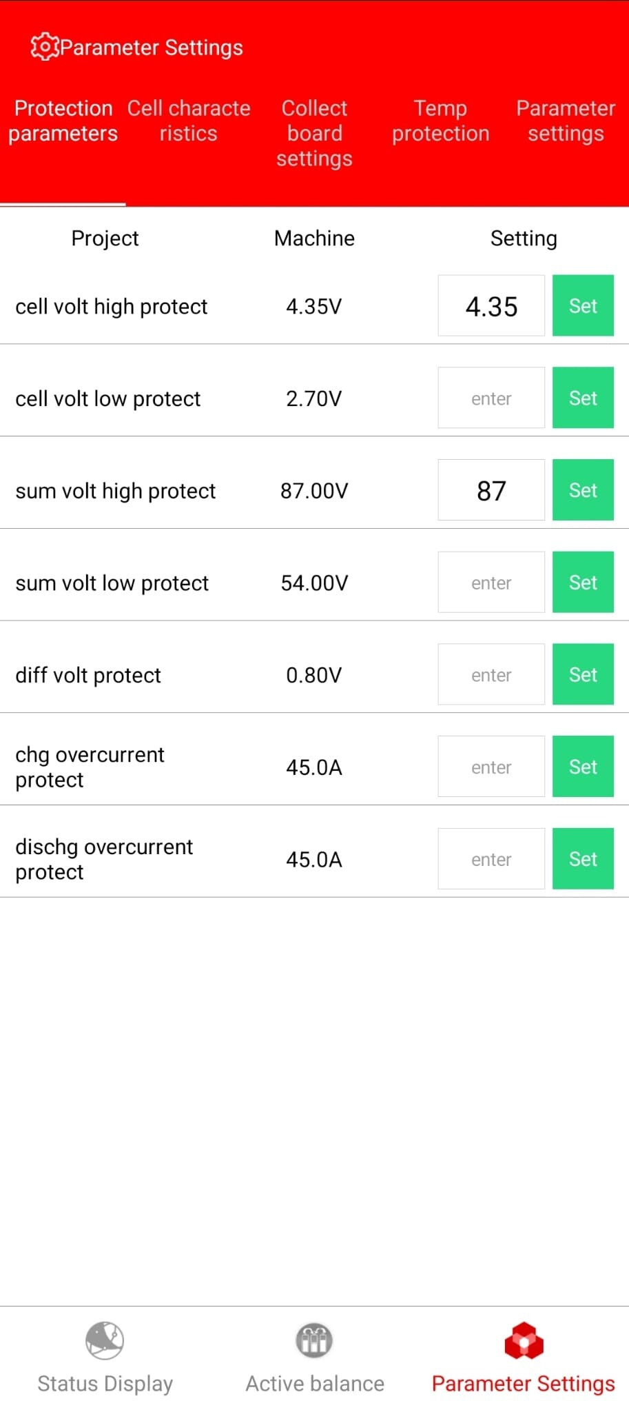

Plug your board into the charger to make the BMS discoverable.
Use the Smart BMS app to connect to the BMS over Bluetooth.

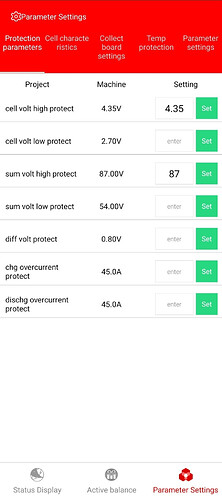

Go to Parameter Settings in the bottom right.
Change cell volt high protect to 4.35v and press Set.
Enter 123456 for the password when prompted.
Next change sum volt high protect to 87v and press Set.
No other changes are needed in the Smart BMS app.
*Do not enable the balancing switch in the Smart BMS app. The pack will balance as needed with the existing configuration.
