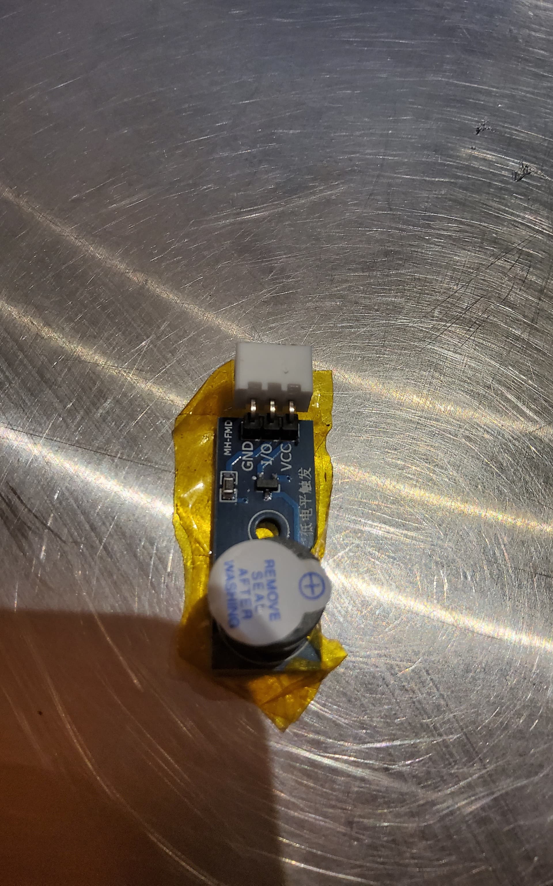

So here is my buzzer, do i somehow have the wrong type ? Its an active buzzer
Is there another way of connecting the wires that won’t result in it constantly beeping or burning out my vesc lol
I ordered those from Amazon too and cannot get them to work, I had to take the little buzzer module off and use it directly (not using the 5V pin) which is unfortunate because it now isn’t very loud…
The “grove active buzzer” however definitely works like a charm!
Oh i was going crazy and definitely barking up the wrong tree. Looks like i need a high level trigger not a low level trigger buzzer. Thanks for dealing with my nonsense hopefully this helps some other lost soul
