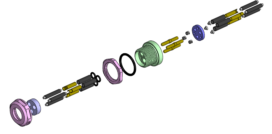

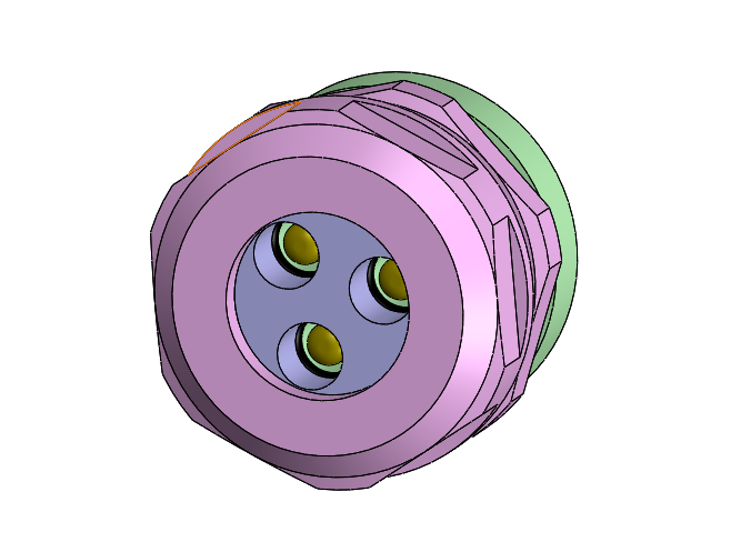

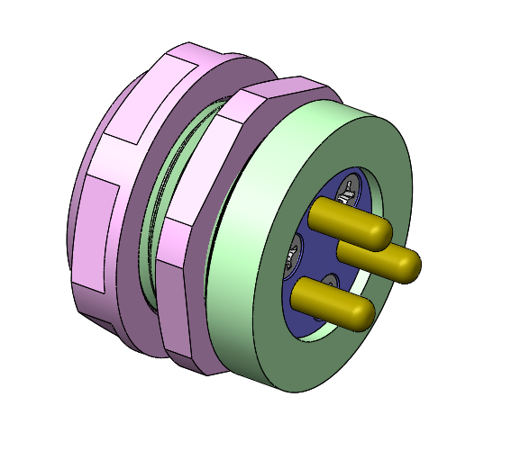

Here is a concept for a weatherproof, through-wall, 4mm bullet connector to simplify motor connections and eliminate molex connectors. The operating principle is when the nut is tightened, it compresses the o-rings around the outside of the female connectors. I’m not sure when I will have time to work on this so I wanted to throw it out there in case someone else is interested. This requires test printing for tolerances and functional testing.
