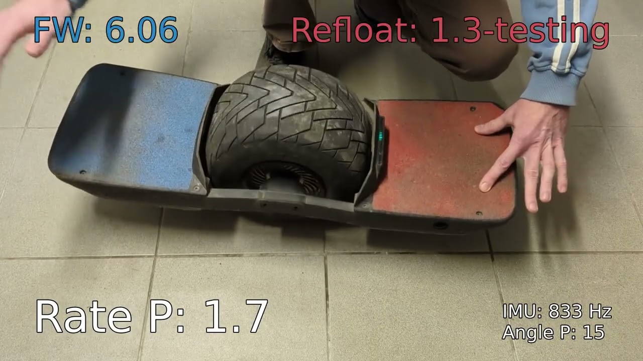

These changes together clean up the data path from the IMU to the package (at least as much as possible with the current hardware). They massively improve the static vibration rejection as demonstrated in this video:
They also have the potential of getting rid of some cases of nose hunting. I have very little data on that atm., but they have resolved a particular case of nose hunting for me (on cobblestones at around 25km/h) and have improved stability for another rider at speeds close to or over 60 km/h.
